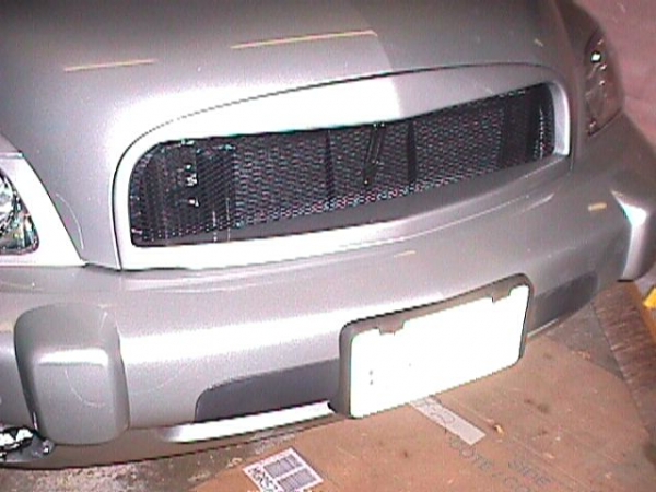

I went with a "no bar" version- check my pics under mikeloftyhhr......

It is best to strip that coating off before painting. I, too, went with the no bar/deep look. I ended up using a 4X4 ABS mailbox post I bought at Home Depot out of their clearance section. I used the outer section of the original grille so I wouldn't have to make mounting tabs. The mesh is also from HD. I'd also recommend not glueing the mesh to the grille or lower bumper. If you ever have to repaint, you'll be doing alot of masking.
