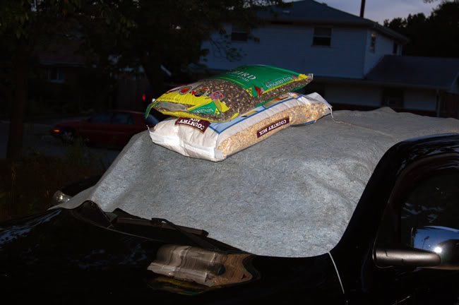

Morticia is Resting after her surgery today.
50 lbs. of bird seed on the visor as a "clamp" for the center glued on the glass area.

I dry fit it and used self tapping flat headed screws on the ends, then quickly took the pics before glue up and weighting it with the bird seed.
Then took one last pic of it all glued and weighted down.
Will leave it weighted at least 12 maybe 24 hours.
The Birds can have at it After that.
I used 3M's WINDO-WELD super fast urethane #08609, for the center glass glueing.
