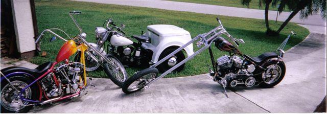

Mine is # 27 of only 425 in the last year..(all documented)... Also only year HD used a Disc front brake, & (auto-style) E-Brake..
& that Big Delco-Remy Alternator is stock.. Although I replaced mine with a chromed 1 wire version....
This current Servi-Car I've owned since the early 80's..
Yes I have double chains, primary & secondary.. My 45" I have bored & stroked to just over 55", with a C/R of 7:1, cams re-ground by Jim Leineweber for a torque grind), stainless chevy 6 cylinder modified valves.. You name it, it's in there...Total Seal gapless 2nd rings.
Also changed the motor sprocket from the stock 22T to a 33T, it can hit 70mph.
My first Servi-car was a 1947 very poorly chopped, but I bought it that way as a kid then.
fwiw: on Servi-Cars, last year HD used a Springer was 1957, then for 58 they began using the Hydra-Glide front ends, w/fixed rake triple tress..
