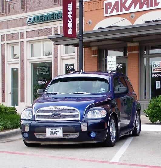

My $1.08 Lower Grille Mod on Shaggy and Shaggy Has New Teeth

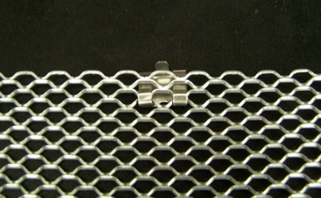

3. unbend tabs on back of stainless clips pretty far out and take off mesh

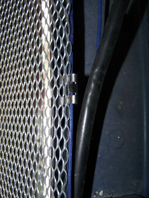

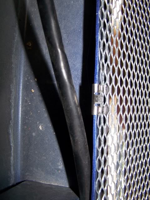

4. at 9 inches in from each side and where there is a flat part on top, put the clip thru the mesh at the 3rd slot down and then take a needle nose pliers and flatten the lil tabs
you are ready to install

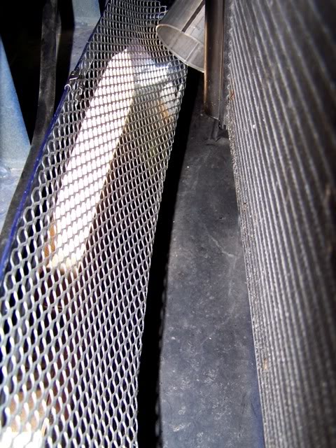

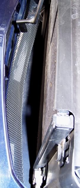

5. make sure that it is exactly between the 2 posts on top and align the tabs on the top of the mesh and push the clips down on the plastic rail there on the inside of the bumper. it goes on snug. the mesh goes along the top and fits snug when you do this
6. wedge the mesh against the left and right bolts coming out of the bumper ( you can buy a metric nut and a large fender washer and screw it down on the post and really secure the 2 top sides down) I didnt have time to go to Turners Hardware and find 2 nuts. i will post tomorrow.

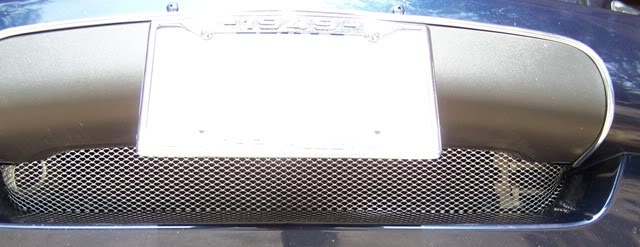

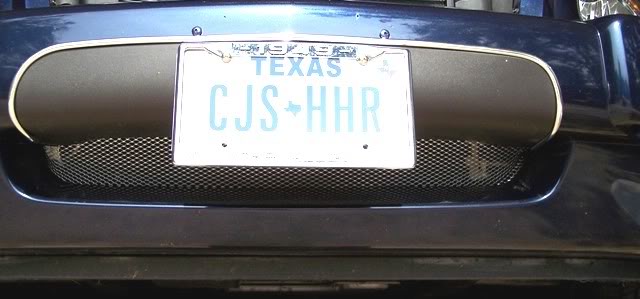

7. gently hold the mesh flat against the hole in the bumper on the back and the with your finger tips, bend the mesh over the bottom edge and lightly and firmly pinch in place. do this all along the bottom edge and sides.
You now have a custom fitted lower grille.
this was way too easy and anyone can do this
