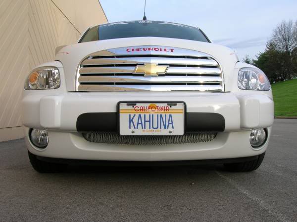

CJ... Great idea for a low cost lower grill modification...
It should keep all those sandcrabs and landsharks off my radiator on my next trip to the beach...

I'm gonna have to give this a try..looks good! I'm still trying to visualize the bottom part and how it is held on by curling it but once I get under the hood it might make sense
Goose
It's really easy, Goose...
The clips on the top simply clip over the lip just above the lower opening. Those clips hold the top portion of the grill from dropping down.
Then shape the mesh by simply curling it around the lower lip of the opening to keep it held up against the lower part of the opening. Real easy and it will all make sense when you look inside around the opening.
