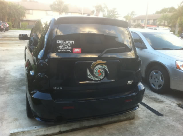

Talking Nite shade the tail lights on the ss
They come out great and didnt even think they would come out so cool.

That looks really good! I want to go the same route instead of expensive LED lights. Was it expensive to do?

Did you tinted them or purchased as shown?

$24.88 was amount for the supplys from pepboys.

I did them myself and still got some left over so can do my camaro tails too.

Very nice, and I'm digging the "swirling vortex vanity plate", when did FL make them available?

Looks good. I did mine as well, but I noticed they came out a little spotty. I'm going to deal with it for right now until I get some more time to sand them down and start over.

How did u prep the tail light? If don't mine me asking.

I washed, then wet sanded them with 2000 grit. Cleaned with wax/grease remover. Then sprayed 2 coats of the niteshades, then 3 coats of clear. Let it dry for a week, wet sanded with 2000 again to get rid of the orange peel, then polished with Megs ultimate compound, then followed that up with a finer polish called Menzerna Po85rd. They are nice and smooth, but the niteshades didn't cover that well, so there are little spots that I can see upclose that didn't cover as well. When you step back and look they look great.
I'm meticulous and I won't let them stay that way for long. I just need to find the time to pop them out and do them over.
