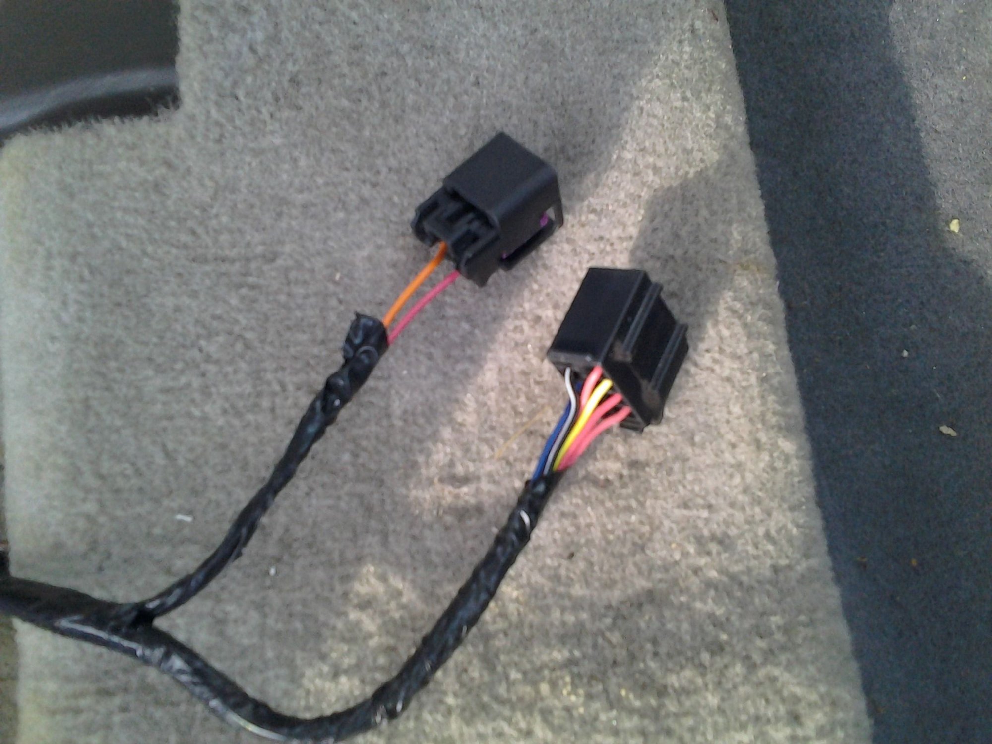

ahh . . . i mis understood that. Glad it worked in my favor . . . I installed the seat heat button panel and plugged the leather seats into the wires that ran to the cloth ones but they do not seem to be working . . . after looking at my owners manual to see if these is a fuse it appears in 08 (my model year) the button was on the side of the seat. The seats i have must have been from a later or something because the switch is by the climate control. . . .anyone have a "work around" for this? . . . again thanks all

Run wire leads though center console to connector?

fuse #47 & #23 under hood? Did you get the module from under the donor cars driver seat?

i got the seats and heat button panel from the same car. i will have to look at the seat harness again as well as the bottom of the new seat. If the 08 had the switch mounted on the side of the seat i cant imagine the later cars with button on dash would be directly plug and play, just seems it would only need a fused direct power lead.

the MODULE is under the seat, the switch is on the dash. You have the wiring diagram, at least I sent you a link. The 15 minutes to DL and install will save you hours of guessing wrong.
I don't know where you are getting this button on the seat stuff.

My bad, actually i was looking at the owners manual to find fuse location for the seat thinking they were never factory installed so it probably never had the fuse or relay installed. i was in a hurry yesterday and quickly glossed over that page, its the switch for the lumbar support that led to me thinking that by mistake ( graphic was on same page lol) just ran out of time but will look at it again today and check the diagram if need be. thanks

drivers seat has two plugs (that are plugged in) pass seat has three plugs on seat but only two coming out of the floor. I will have to look into the wiring diagram when i get close to my other PC. I dug up some old threads on this very subject, retro-ing in heated seats to non equiped cars . . . . seems i got my work cut out for me . . . . lots of great info on here
