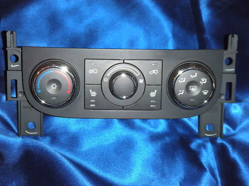

You will also need to swap out the climate controls that have the 2 heated seat switches and on mine those plugs were there so just plug em in.
Then you must go to the Dealer and have them turn them ON in the cars computer BAC whatever it is. Won't work until you have the dealer do his thing.

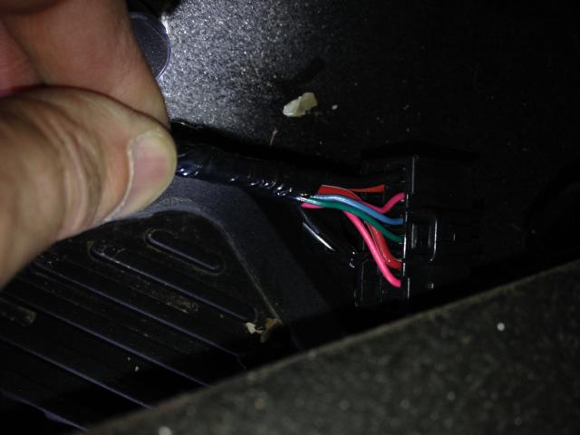

This is the drivers connector of an hhr with heated seats.
The the connector and the five wires in the top or the connector you can see in this picture are needed for heated seats.
Red and white wire is battery pos.
Pink wire is key on pos.
Then pink,light blue and dark green go to the a/c controller.

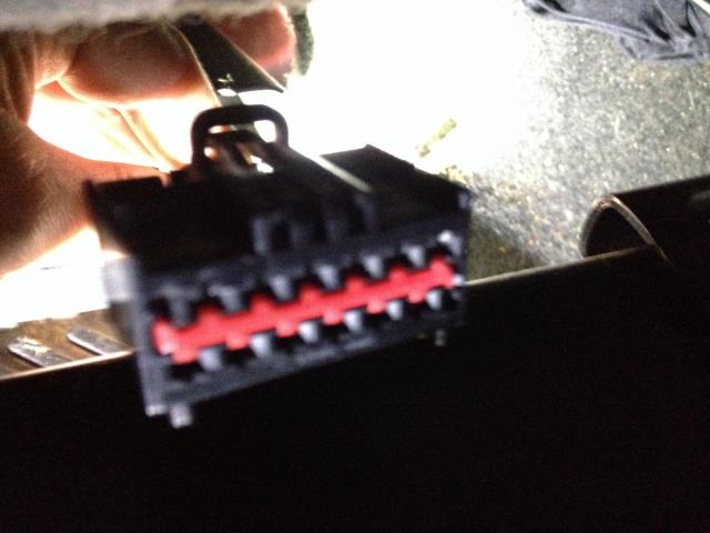

Here is a picture of the front of the connector.
