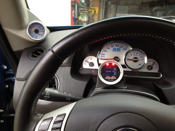

Been there - Done that ..... What a Fiasco and I wouldn't recomend it as a Mod .....
Here's our thread and write up:
https://www.chevyhhr.net/forums/general-hhr-4/140-mph-ss-speedo-mod-install-25572/
and a photo of our final install .....
Long story short! Use your original cluster as it has some security features run through it! We replaced all of the LED's to bright whites! Used the gauge face from a donor SS Cluster! When we had Trifecta write our tune, he re-wrote the odometer to register 16% less that makes the speedo then read at the correct speed .....
oh and to SS Fan, yes I have taken it up to over 123+ mph returning from Tom's Farm (SoCal) on highway 5! My remark would be "She's Gunna Blow Captain" .....
