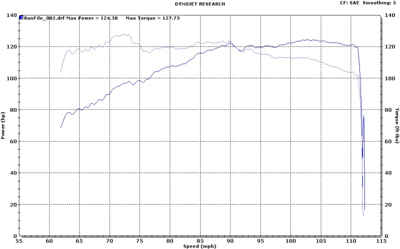

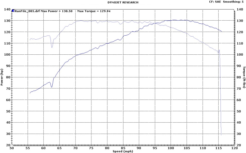

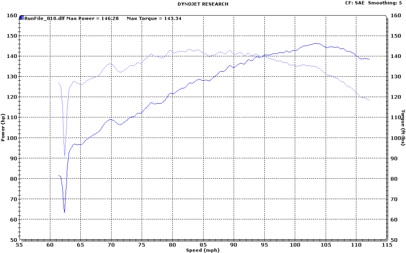

Apparently my fiance was bored and decided we needed to dyno my HHR, so he put the stock tune back in, ran it on the dyno, then put his tune in, ran it on the dyno again unloaded, then loaded the dyno and ran it again. Here are the charts and then the video at the bottom is of the last run.
Stock Run:
Unloaded tuned run:
Loaded tuned run:

Interesting results there, some definite gains across the board, just as long as his boredom doesn't turn into "Honey I Blew Up the Engine".

Edit: Apparently he was having problems with the torque converter not staying locked like he wanted which is where all the weird dips are from on the charts.
