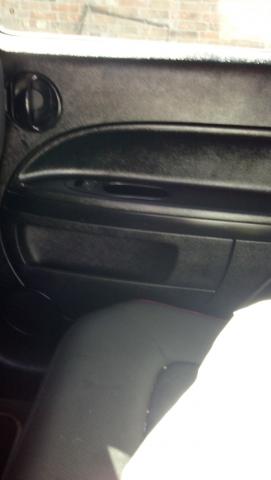

So I sanded down one door and painted it black. Rest of doors and everything will be painted black but the seats...
I love how this paint looks wet..

Looks good, planning to convert my interior as well...really dislike the cashmere. Was it paint, or interior dye...and what was your prep?

Well as the pleather(the red material) couldnt be sanded due to it would fall apart, i saned the silver part and all the black with a 1500 grit. Then used a adhesion promoter then the black. Took 55min for that one panel, that included taking it off, painting and to put it back on. The rear doors are easy to get off. The fronts... gah

Looks Good man..
Cool, that doesn't sound too bad. A nice TX day and a six pack should make that a fun day of interior mods...lol.
