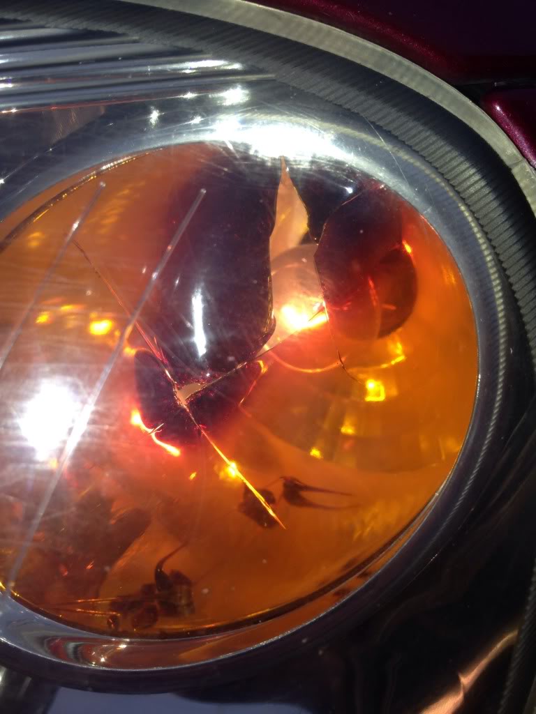

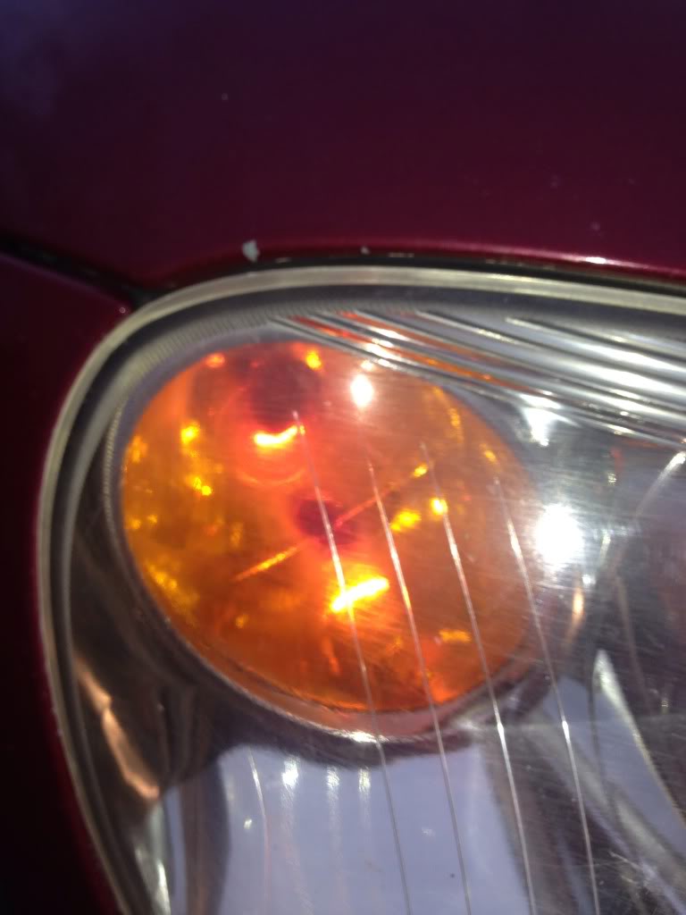

I am resurrecting an old threat but this is what I noticed today on my 06:
You can see the amber plastic melted in the housing. Very strange.
I will have to replace them for sure. Good time for Depos, I guess. Do you guys think there might be any risk of fire?
Cheers,
Leo

None of the above. I believe it is faulty design. Everything is original in the car and while I am the car's second owner I know the previous owner and they kept everything original.
After much reading online this appears to be an issue with 06 HHRs and Malibus. GM never officially acknowledged the issue and the best fix seems to be new housings and LEDs for turn signals so they don't get as hot when used as DRLs. In 2007 they DRLs were switched to the low beams (which tells me GM did know something wasn't right!) .
I will take it to the dealership and show it to the service manager but I am sure they will offer to fix at the rate of U$90/hour and 300-plus dollars for a pair of OEM housings.
We'll see...

About to start a thread when I found this, I to have a 2006 that I purchased in 2007 with 22K on it.
My passenger side is about as bad as the picture above and the drivers side is getting close.
Haven't decided on how I am going to go about repair yet, but wanted to let others know, another one has it!
