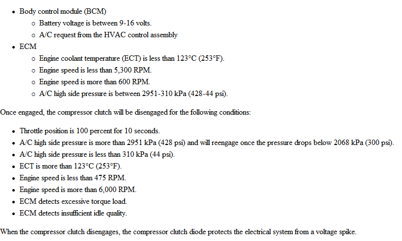

Note the DRL wiring in the attached schematic. 2 fuses to the left side then the right side.
There is a common point in the A/C compressor and left headlight circuits; G109 at the left strut tower. Link:https://www.chevyhhr.net/forums/how-...cations-56504/
The A/C compressor will turn on if:
Attached Thumbnails 07 HHR Electrical- A/C cycles on/off, left lo beam & left parking light won't turn on-acconditions.png
