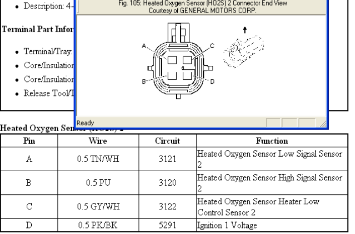

P2270 points to #2 O2 sensor STUCK LEAN. That means that either the sensor is bad or the is an electrical problem.
I would check the wires and connectors to the #2 O2 sensor. Especially suspecting pin A and B

Originally Posted by donbrew
Minor correction: OBD codes start with a letter then a 4 digit hex code, some do have letters in them. I think it's hex, maybe octal.
I will start here, I did remove the flex pip a few months ago thinking that was the problem but it was good, so ill take this to the mechanic who did the work and see what they say.
