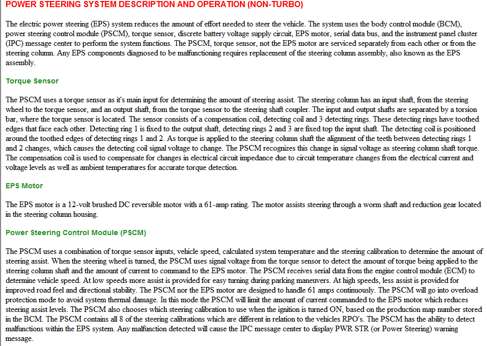

Things involved with EPS:
the Steering wheel position sensor/torque sensor
the PowerSteeringControlModule
Both require a new steering column
Check for loose connections and worn wires around the steering column
Description from Mitchell OnDemand, disregard the sentence about the motor needing to be replaced with the entire assembly
non-turbo EPS
