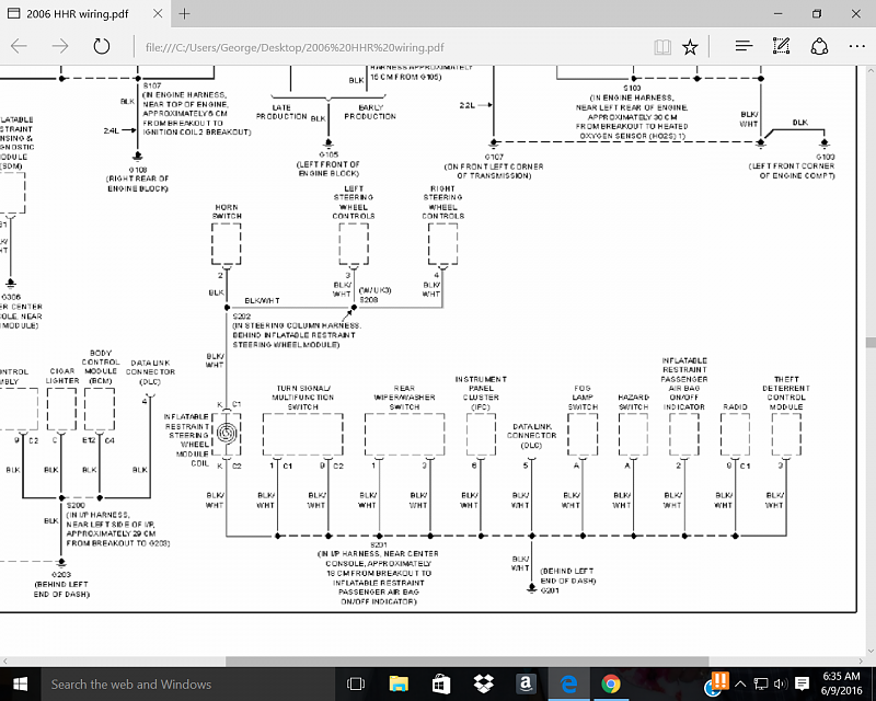

I have a similar problem. My climate controls don't work but my fan does. I have no lights in the climate controls my passenger air bag light doesn't come on and my steering wheel controls don't work. Any help would be greatly appreciated
Old Jun 9, 2016 | 06:16 AM
Posts: 11,719
Best to always state car info(year and model) when seeking help.
Based on the items listed not working, check the ground connection at the left side of the dash.
The HHR schematic shows that to be the ground point for the steering wheel controls, passenger airbag light and a few others.
Old Jun 9, 2016 | 06:46 AM
Posts: 11,719
Playing around with screen capture.
2006 HHR Climate control Worked One day and Nothing the Next Day Wondering-screenshot-2-.png

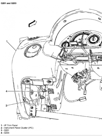

Old Jun 9, 2016 | 08:04 AM
Posts: 26,490
https://www.chevyhhr.net/forums/how-...cations-56504/
And g201/ #3 in this drawing.
