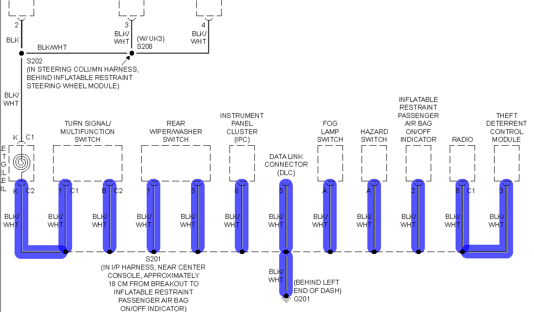

I'm playing with my new OD5 installation and snipping tool.
Ground seems to be the common thread in the non-working stuff.

Flickering kind of says : loose or corroded connection.
The only common link seems to be the ground wire, but could be a short in one of the components that does not work (maybe the clockspring). 2006/2008 should not make much difference in wiring; some wire color and pin positions changed that's about all.
