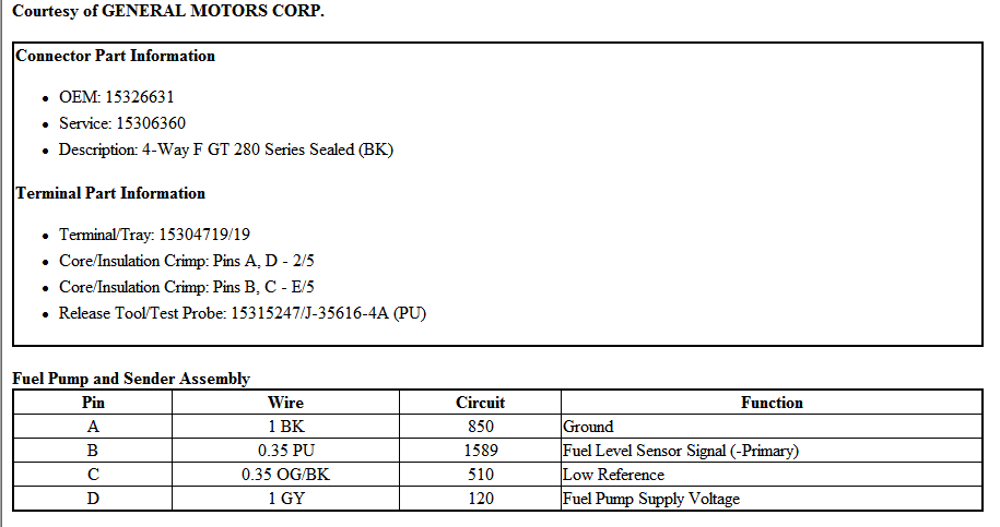

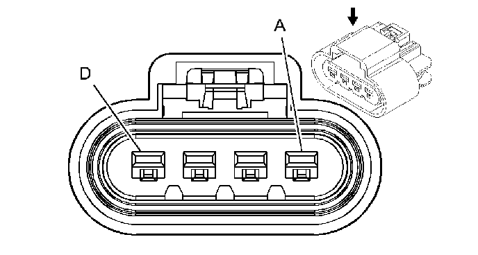

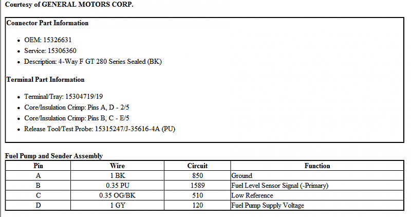

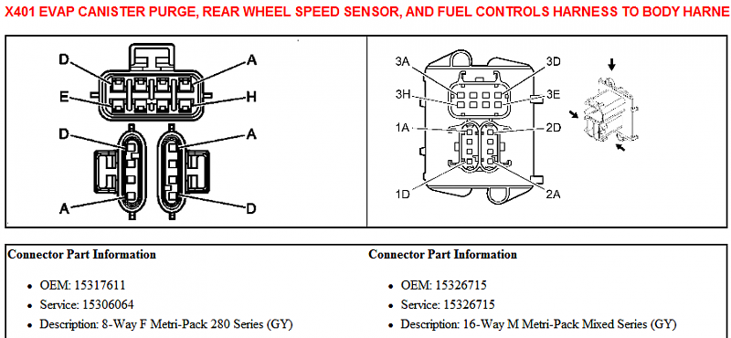

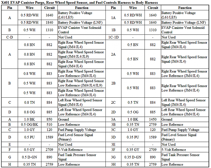

WOW!!! Those diagrams are AWESOME. Hopefully the 2007 wire colors are the same. :)
I'll jump back there again tonight and check the power outputs at that plug. Armed with a volt meter and this diagram; should yield something very tangible IRT a diagnosis. THANKS. Let ya'll know how it goes.
