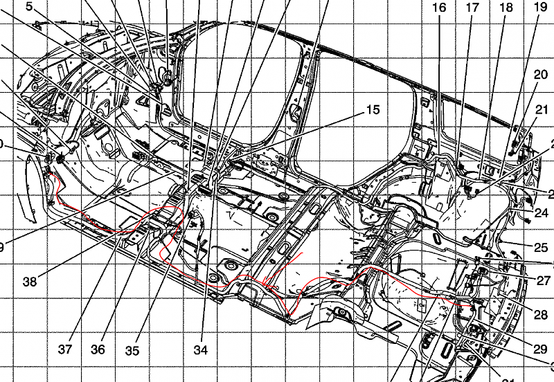

I believe the harness runs along the driver side sills then across under the rear seat frame then out to the axle beam.

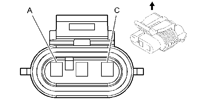

Donbrew, When the ignition is initially turned on, I am expecting 12V (the primary power for the pump) on at least one of those wire connections coming out of the body-mounted electrical connection/block by the pump...looks like 3C on diagram. None are showing 12V to body ground. I understand that if energized properly, the fuel pump will kick on for a second or two until it builds enough pressure to kick off the built-in fuel pump pressure regulator.

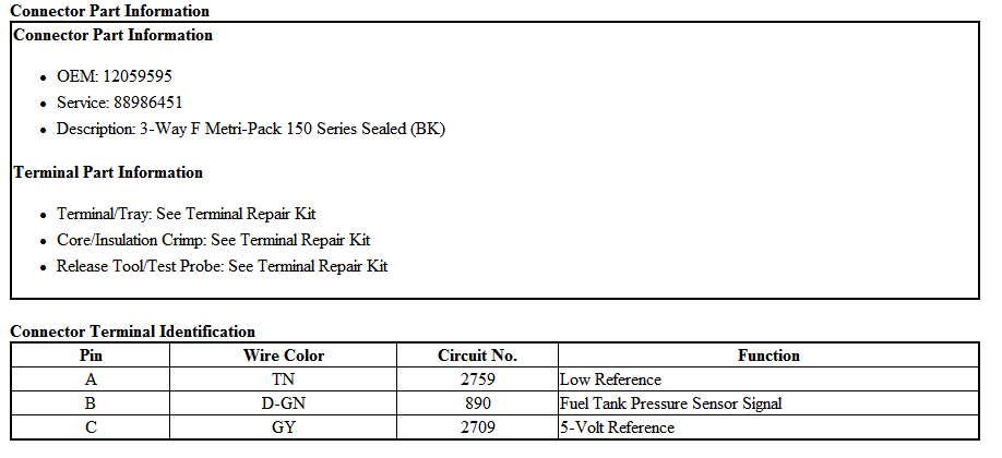

The connector in post #16 does not agree with your reality because it includes a couple of LNF only connections (SS/2.0L).
Also, I didn't bother to point out the bottom diagram and the top connector are mates.
As to 5V, ever hear of computers? Regulated 5V is high reference, low reference is regulated 0 V (technically anything less than 5V, but ground/0V is easier). When you have regulated references, the computer can give a number to an output.
Imagine what the reading would be using a variable 11.5 - 14.5 Volt reference and a suspect ground. How would the computer know what .5 is?
There are no other connections that I know of between the fuse box and the chassis harness connector. Either there is a broken wire or you are measuring incorrectly.
This is the fuel pressure sensor connector an pin out along with the body harness routing, it goes through the sheet metal somewhere and connects to the axle beam etc. You have been under there so I assume you have seen where it emerges.
You could check continuity of the grey wire. Be sure to disconnect both ends.
Pin 3C on the body harness connector should be the pump supply voltage.
