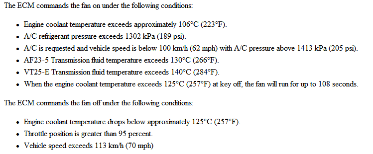

Without the A/C on the cooling fan does not start until about 223F.
The A/C controls the fan operation by refrigerant pressure. Could be the refrigerant suddenly leaked out or the pressure sensor broke.
There is a misprint in the "off" section that should be 82C/180F
Fan is off probably because the computer does not "see" the compressor as being on.
Fix the AC problem and the fan function should return.
