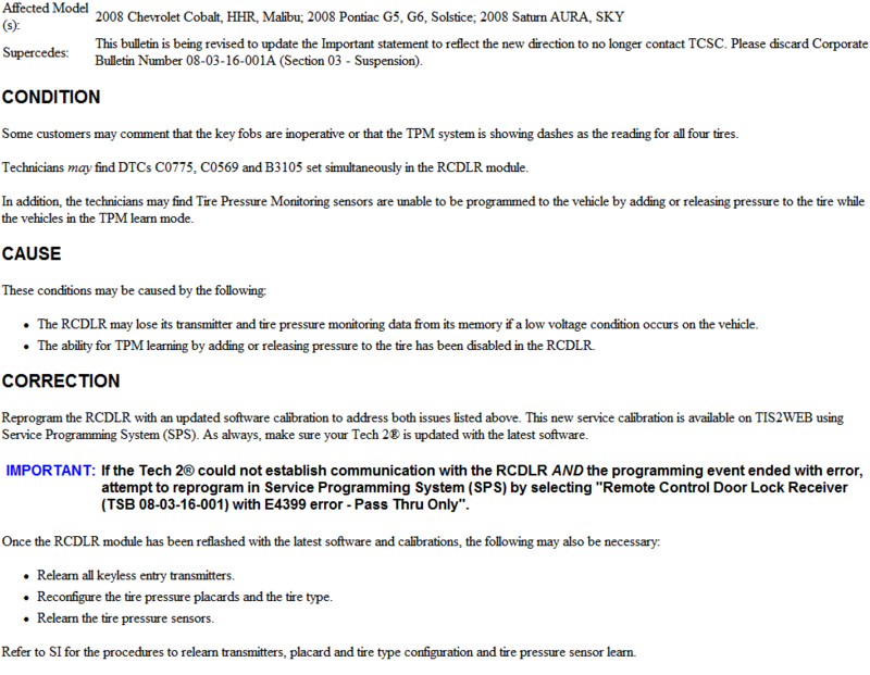

Where's our moderator Donbrew when we need him. There is some sort of TSB regarding 2008 models, dead batteries and the car's computer needing to be reflashed.
Hopefully Don will see this and impart his wisdom on your issue. Just standby till he see this thread.

Here it is also, check the "RDO" fuse #24 on the BCM, fuse #26 on the BCM just to be sure.
Assuming you used the bolt on the strut tower for ground when jumping.
I will move this thread to "problems and service".

That's because its a 2009 NOT a 2008 as stated in the TSB.

I had the same issue with my 2008, had to get a reflash from the dealer to reactivate the radio receiver module that is used for both tire sensors and keyfob.
