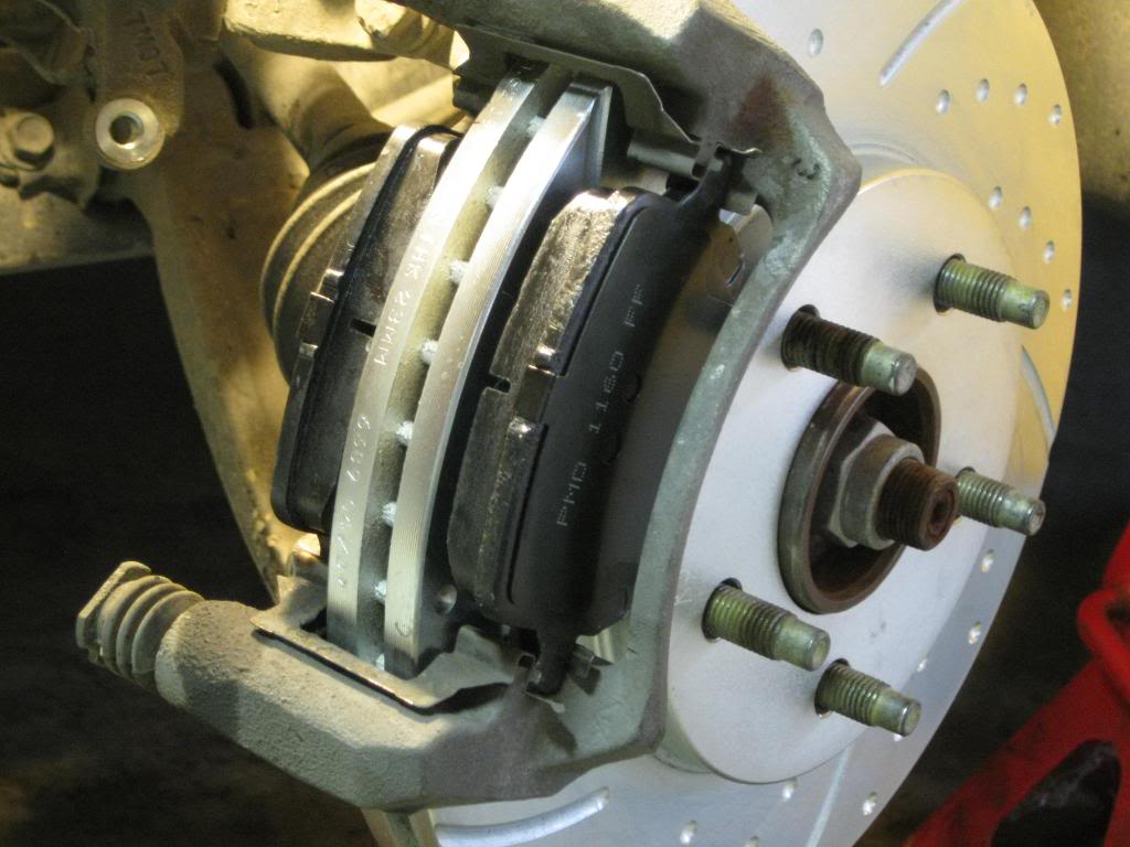

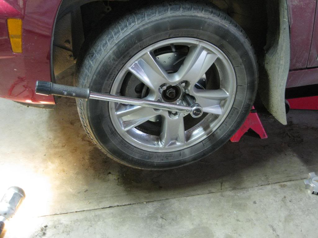

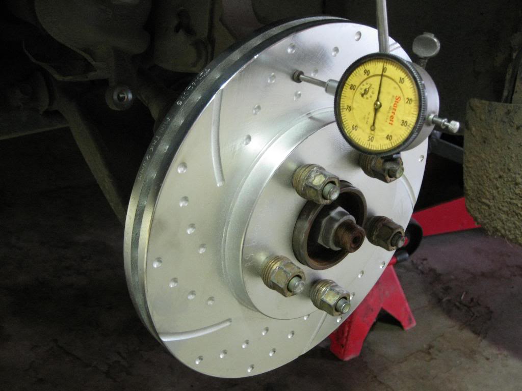

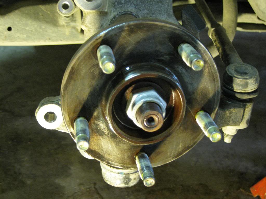

Here is a post detailing my brake job.
After one resurfacing by the dealer at 8-9000 miles the shake about took the wheel out of your hand at 20,000 miles so I ordered new rotors. Put them on today and documented the job with pics just in case they warp because they have a Lifetime Warranty - Against Warping. Got free pads with them. Broke them in tonight and things are so smooth now. Here is a link to where I got them.

After removing the brakes and old rotor I cleaned the hub surface

I installed the new rotors and tightened the rotor down with old lug nuts. I then checked the run out with a dial indicator. They were perfect.

Installed the new pads

And installed the wheels and torqued at 100 ft. lbs.
