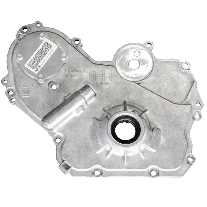

Rotate the crankshaft clockwise only , until you feel or hear air exiting #1 cylinder, ensure the piston come to TDC , check the timing mark on the harmonic balancer, there is a notch on the engine side it must line up with the mark on the front cover
See the raised line just above and to the right of the oil pump spring housing , just below the 10 KW marking
