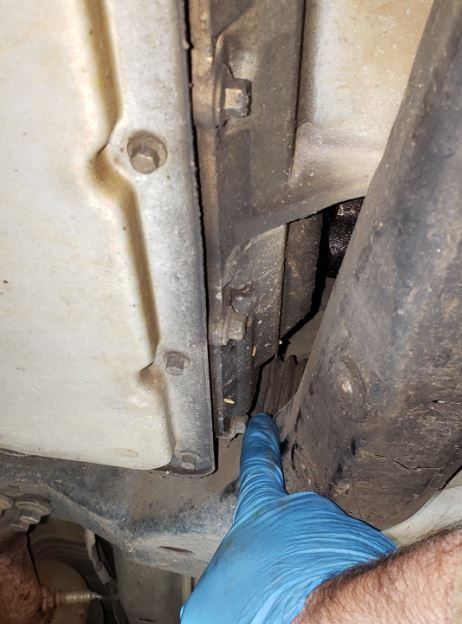

Another question. I have been reading where others have done this repair by dropping the cradle (while supporting the motor) just to get enough room to get to the solenoids. I thought the whole reason for this was because there was not enough room between the cradle and the transmission cover bolts. From what I can see on mine is there seems to be enough room to get all the bolts out. The one that is the closest is the one on the bottom corner closest to the firewall. It would be great if I did not have to drop the cradle and I could remove the cover. Unless the bolt is really long, I think I should have enough room to do it. I made a picture from underneath of the bolt in question. Does this look like I have enough room or is this the problem that everyone else has doing this job? The bolt head is just to the left of my finger.
Thanks

Once you get the cover off how are you going to get to the solenoids? Very tiny hands and an extra joint in your forearm?
That's why.

I thought once the cover was off, I could access the solenoids. I have not checked for the codes yet. I did not have a scanner with me today.

As fastsuv explains, you have to drop the cradle to drop the transmission, for room to remove the side pan. There’s photos in this thread
https://www.chevyhhr.net/forums/driv...d-61313/page3/
