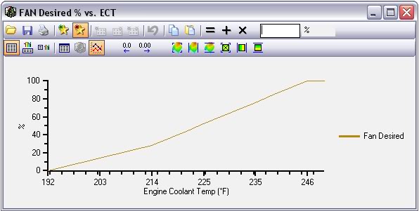

The fans should come on progressively, not just on/off. But they should definitely be spinning by 230+.
Here is a chart from hp tuners showing fan speed vs coolant temperature. This is a 2008 2.4. I checked a 2.2 file as well and it was the same. They were cobalt files, but hhr's should be similar if not the same.
