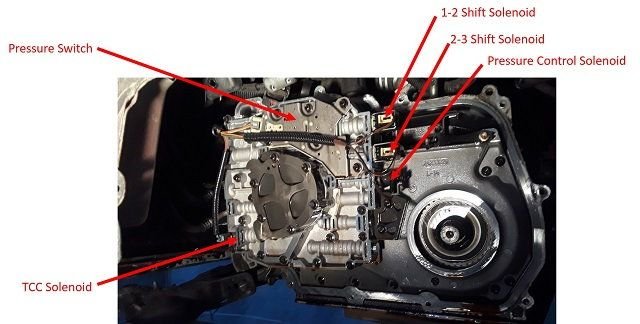

Change the shift solenoids and have a look at the fluid tubes above the fluid filter. The solenoids should have a code like P0977 .

With the side cover off the solenoids are easy to replace Note the subframe is dropped several inches
Notice the melting plastic clip on the second solenoid, this was the 2-3 shift solenoid
While you’re at it change the other solenoids Photos courtesy of fastsuv.
