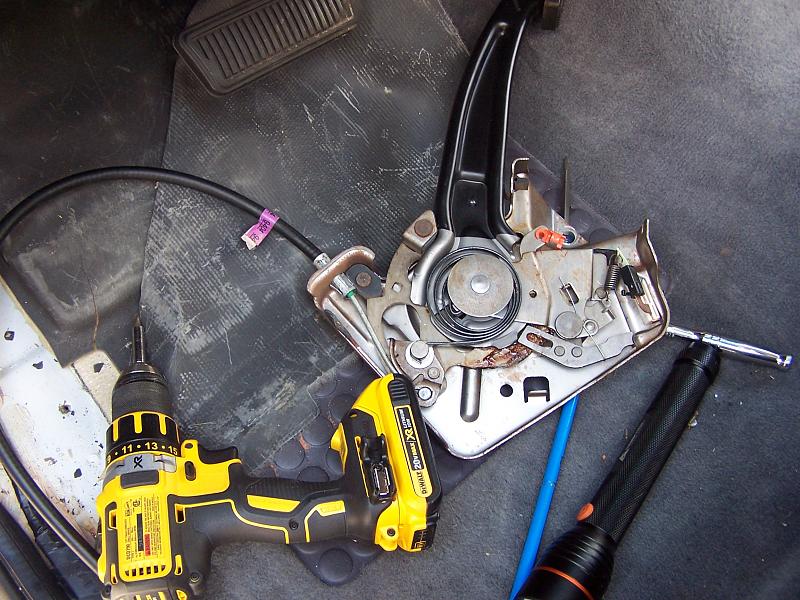

I was actually thinking old fashioned cars. The only thing that turns the parking brake light on is the parking brake light switch. The cable or the brakes are not properly adjusted.
The micro switch is #1 in the drawing, on the passenger side.
Funny thing. I happened to be looking for a small water leak in my Dodge truck this morning. Somewhere high up on the drivers A pillar.
The funny part was I had to remove the parking brake assembly so I could see up in there. I guess it was some weird karma that had me working on this and trying to also answer in this thread at the same time.
The Dodge
The Dodge
