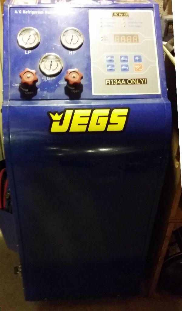

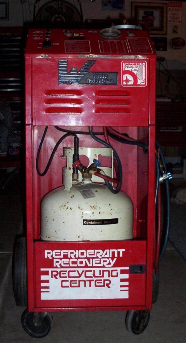

R12 is not illegal. I still have about 11 lbs. of it. It can still be used in vehicles the are set up for it. It cannot be mixed with R134a. I really doubt the he has expensive AC equipment. He said a 'reclaimer'. Don't know what that is. He could just mean a tank. If it has anything to do with R12 he need to keep it as far away from his HHR as possible. I have two recovery/recharge/recycling machines. The old one I use for R12 and the newer one I use for R134a.
