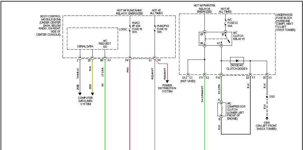

what i have is my ac unit does not want to turn on i changed the ac compressor and sill does not turn the compressor on
now i read on how to jump it from the fuse panel when i jump start the clutch it does run the way it gets cold and the radiator starting there has to be something other then the ac not running

Straight jumping or direct jumping just means that you are bypassing the rest of the Hvac's system electronics.
Since the compressor operates and cools when jumped, the mechanical parts of the AC must be working. Time to figure out the electrical issue.

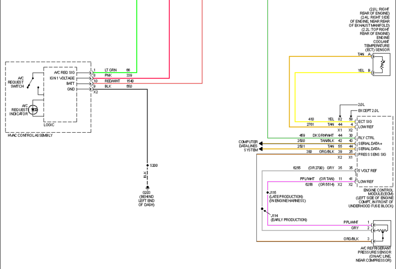

The code we are worrying about will come up early; it has to do with the engine not warming up fast enough. Many times after you shut down for a while then start back up the A/C will miraculously work. It could be a pending code that would not set the light.
Other than that; the pressure switch or the control knob switch or the diode have been known to go bad.
