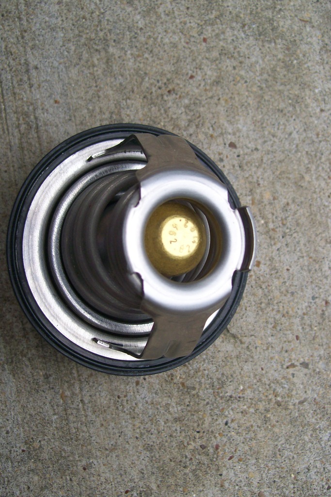

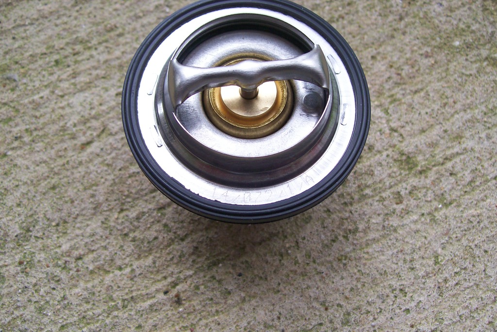

Below is the thermostat out of the old engine with a blown head gasket.

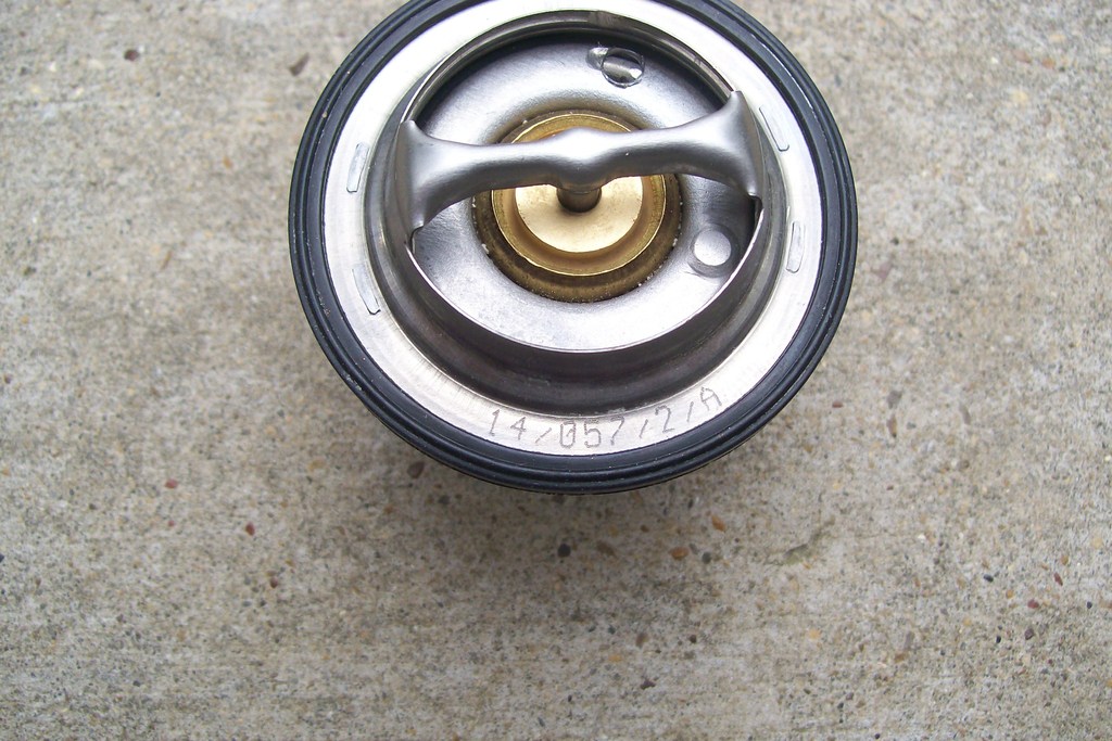

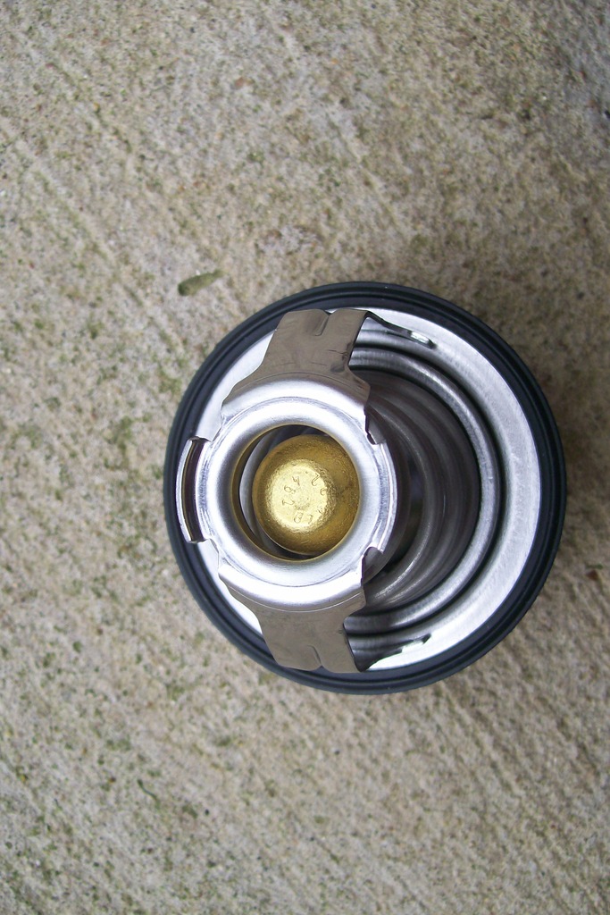

Below is the brand new ACDELCO (ACD#131-158, GM# 12622410) thermostat.

I can't make out the markings. Are the 180F? If they are the engine temp should hang around 190F while cruising.

The old one has a hole drilled in it? Old school but not great for a computer controlled Ecotec
The markings make absolutely no sense to me. I was hoping someone could shed some light on this. The new one is a 180F.

Usually the diameter in mm and the temp in C. Any other marking are only meaningful to the factory.
I would expect an engine with a 190F to run just over 200F. And the fan to run most of the time, it is set to come on at about 219F and turn of at 180F.
