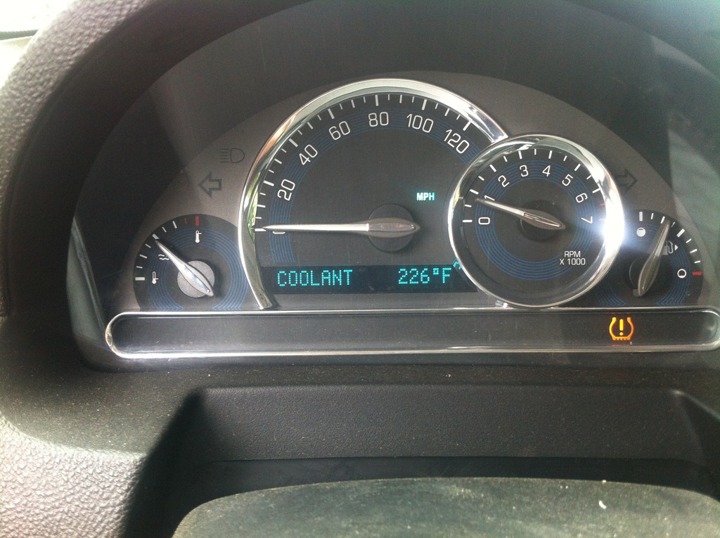

Am I overheating?
Whoa !!! 226 Now that would concern me.....

I would not think that coolant type would make a difference, but sure, I'll empty and refill with dexcool in the morning. Now about the filling procedure, what is the correct way?
To begin with it takes just under 2 gallons, 2 if you also fill the the overflow tank.
This works for me:
Fill to top, leave cap off, run till it gets to at least 180F(so the t-stat opens) the level should go down, top off, turn off let cool. Check level, top off, replace cap, run until it reaches over 180F, let cool, check level, top off.
This works for me:
The wrong coolant type won't be the cause of your over heating. I was just stating it's wrong to use that generic, "fit anything" coolant.
You really should take a look in your owners manual for specifications and recommendations.

Also, donbrew gave a pretty good description on filling the system. In your post, I didn't see anything about warming it up with the cap off until the thermostat opened. That's where I assumed you could have gotten air in the system from not doing the "burp" of the system.
HHR's seem to be a little tricky to get the air out when refilling. If doing it without a specialized filling machine, it has been said that you should at least have the front of the car elevated somewhat when doing this work.
