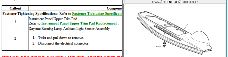

Anyone know the procedure for changing out this sensor?
Old Oct 3, 2017 | 12:06 PM
Posts: 26,532
Why do you want to change it? Do you have a B2645 DTC?

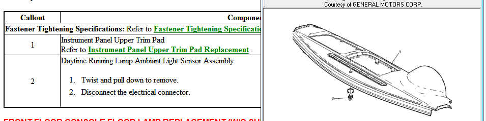

Attachment 45793

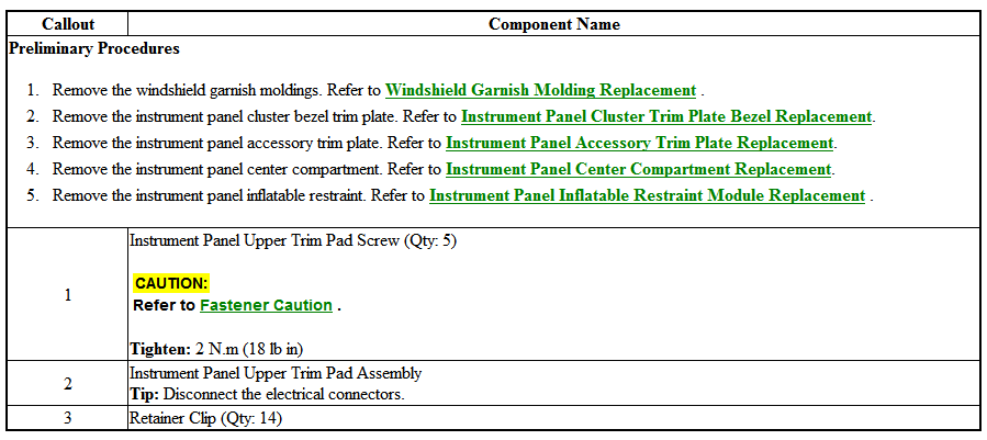

The headlights come on no matter the ambient light setting. It's a cheap part to replace. Thanks for picture. How easily does the top of the dash come off?
Old Oct 3, 2017 | 01:13 PM
Posts: 26,532

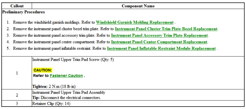

Headlights or DRLs. I just have not heard of many failing, and there are DTC associated with it, if you have a very good code reader.
Not very easily.
