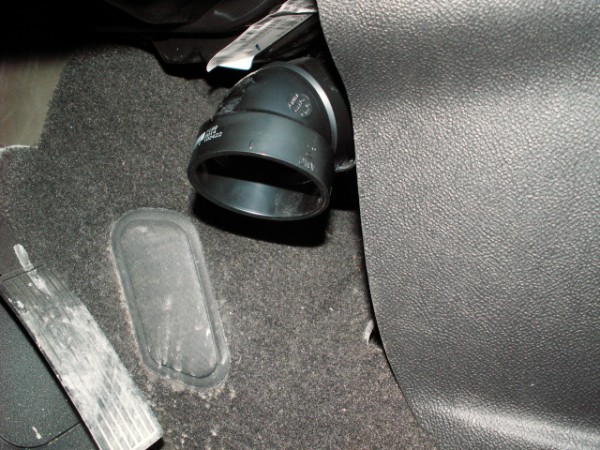

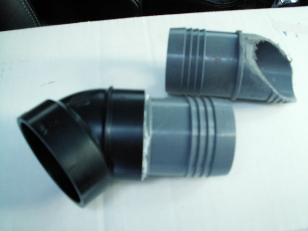

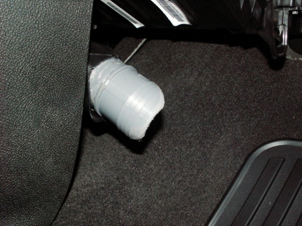

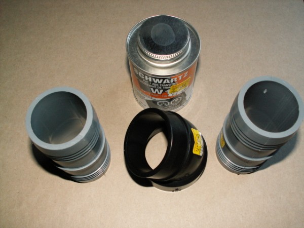

My fix!
Parts used; two 2 inch gray plastic straight nipples for plastic pipe, one 33 degree black PVC elbow, glue (for plastic pipe but ended up using plastic emblem adhesive instead). Black, gray, and white plastic fittings are not necessarily compliable and will not always fit together.
Left (drivers) nipple shortened with elbow installed and right (passengers) nipple cut at a 45.
Installed: glued into ducts, left seems good, but right one I maybe should have use a black elbow. It’s kind of ugly.
Total cost; $ 10.00 cdn including the glue that I didn’t use. High from glue fumes…No charge
Total time; 10 minutes to find parts,
1 hour to visit with friends in hardware store,
20 minutes to install,
Two hours to get pictures into message.
I’ll let you know how it works.

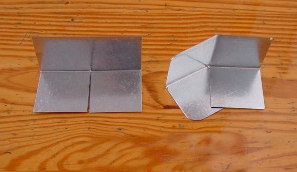

Adjustable floor heat diverter:
material: 2" x 2" x 10' roof drip edge...$3.29 @ Home Depot
As pictured below:
1.) cut 4" long piece of drip edge & flatten raised edge
2.) mark & cut one side @ 2"
3.) bend uncut side to form a movable/adjustable hinge
4.) remove sharp edges
5.) attach with duct tape
I have one on each side and prefer to keep the right side nearly closed for more heated air to driver side.
