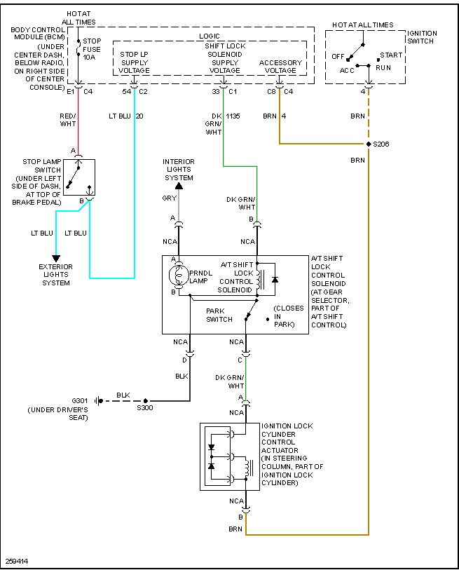

Brake lights? Believe it or not the interlock depends on them working. #9 fuse inside box.
Does the radio work? Does the remote door lock work? (fuse 23 inside)
Are you sure the DIC is programmed right?
Could be the BCM has gone whacky, that unfortunately does need a Tech2.

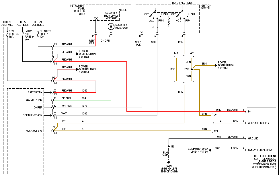

The P0449 is most likely the EVAP vent solenoid (near the gas tank) about $20 15 minutes under the car.
Does the security light flash when you lock with the fob? It is supposed to.
Have you changed keys recently?
Here is the anti-theft circuit.
Attached Thumbnails Another No Start issue, with a twist-sec1.png   Another No Start issue, with a twist-sec2.png

No on changing keys... Nothing since the recall was done last year.
Brake lights, remote lock/unlock and radio all work and yeah the security light flashes when locked with the fob.
I haven't changed any DIC (driver information center) programming since I bought the car... If that's what you meant.

Old Aug 30, 2016 | 05:15 AM
With the BTSI(Brake Transmission Shift Interlock) solenoid being controlled by the BCM, it's acting like an undervolt/grounding issue.
I'd check the battery ground, and also the ground strap up front which goes to the radiator support, plus the Positive connection by the fuse box.
