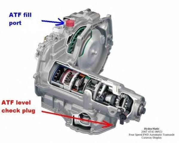

like this.....

Best thing is not to mess with it.
We would weigh them at the factory in Windsor to determine how much fluid to put in when it was assembled.
If you don't put enough in, it'll slip. If you put too much in, it'll froth over at the top breather cap.
If you put the wrong tranny fluid in (a non Dexron 6 wannbe) say goodbye to your tranny.
The dealer can get the serial # record and put what was in it when it was assembled/tested/shipped.

The car must be level and the ATF must be at 104F and the motor must be running. Then remove the level control plug.
Why worry about the ATF level to begin with? Where could it go? Onto the ground is the only place.
Most manufacturers have realized that now. Plus with synthetic ATF being long life.
