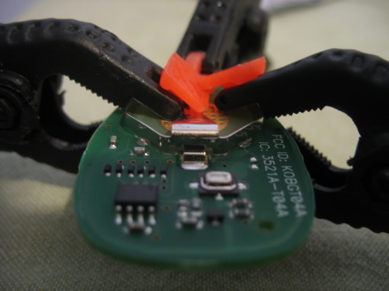

I finally got around to fixing mine yesterday. A quick solder job and it works fine again, resoldering the two small connections on the arms of the battery holder, there wasnt much solder on them. Be careful that you dont jump the solder over to the button pad though, its a little close.
I am an electronics/computer engineer and looking at the way these were designed it seems likely that they will fail, I have no idea why GM would have made them this way.
They decided to put weakly soldered electrical connections on the flexible arms of the battery holder, which is something I would never do. It seems they could have just designed the circuit board to use the large solid connection in the middle of the battery holder that does not flex. If another repair is necessary, I may just put jumper wires from the small solder points to the large one, that should last.
And after a quick look, it seems each of the small battery connections power one side of the remote, so if only one breaks it may leave half the remote functional. That is what happened to mine, the unlock button stopped working first.
Heres a couple pics showing the two round holes to solder and the top of the board with the battery holder. I used three small clamps to retain the battery holder and hold the board up.
