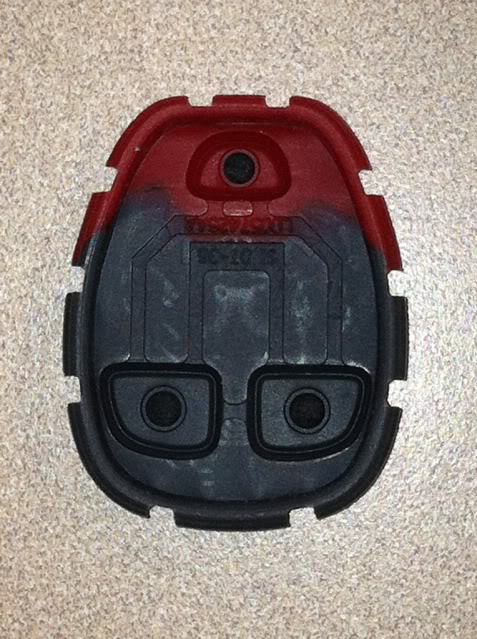

Mine was fixed for about $10. eBay replacement rubber button pad. The bottom of the buttons have a carbon coating to make the switch but it wears off. That's why the panic button will still work.
Size:  87.5 KB here is the underside of the pad with contacts
