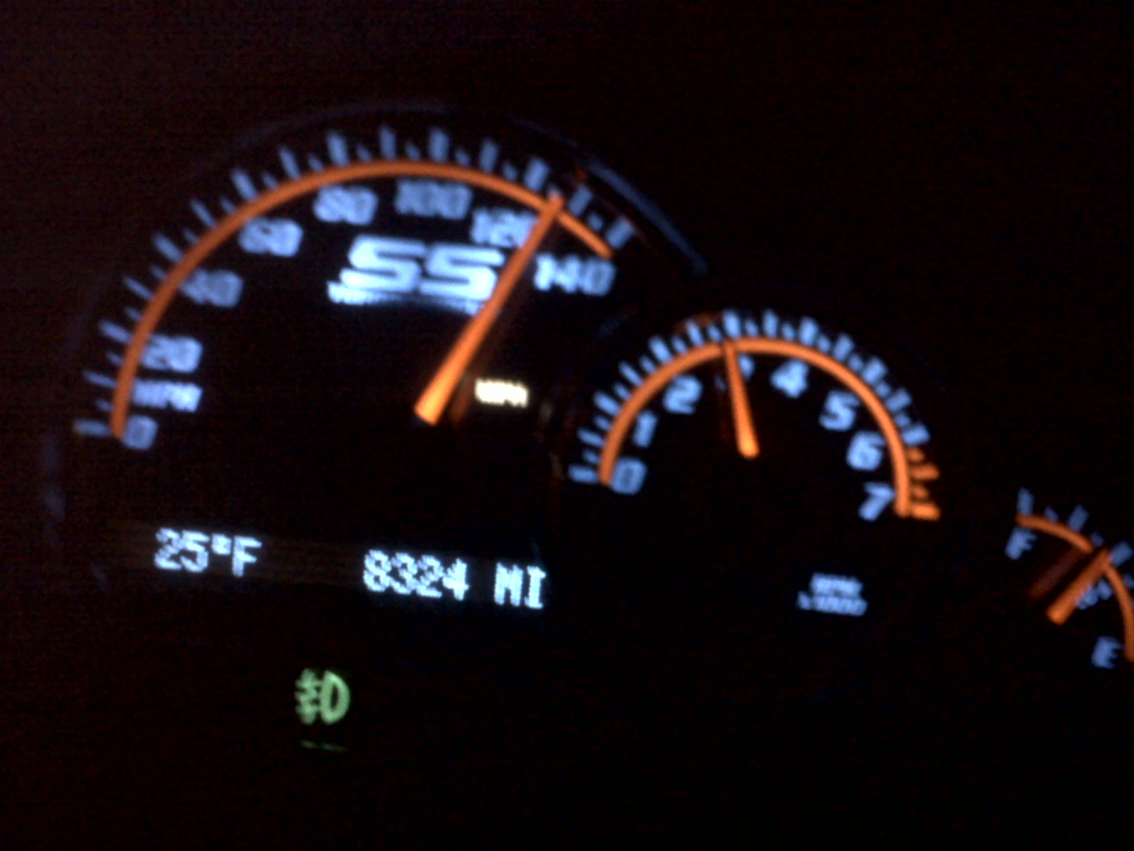

When this was happening I remember thinking to myself... that bouncing the needle can't be good for the gauge itself.
Fast forward...
Weird thing yesterday while rolling down the highway just north of lansing, gauge stuck at 70mph, when I sped up from 60 back towards 80... it rose to 90 and stuck.... stayed there, even off/parked for 2 hours, till some point going home from harrison. Then it was slightly up and down around 130-140+ Stuck there.
Then when i got off the highway it started to work again... it was moving when it should but when I was at zero, it was at like 50. So when i was doing 50 it read 100.
Parked it last night at 40mph. Today I came out, and noticed when it did it's needle check it started to fix itself. Turned the key on & off a few times... it fixed itself and is functioning fine now... 0-100mph all fine.
WTF!
