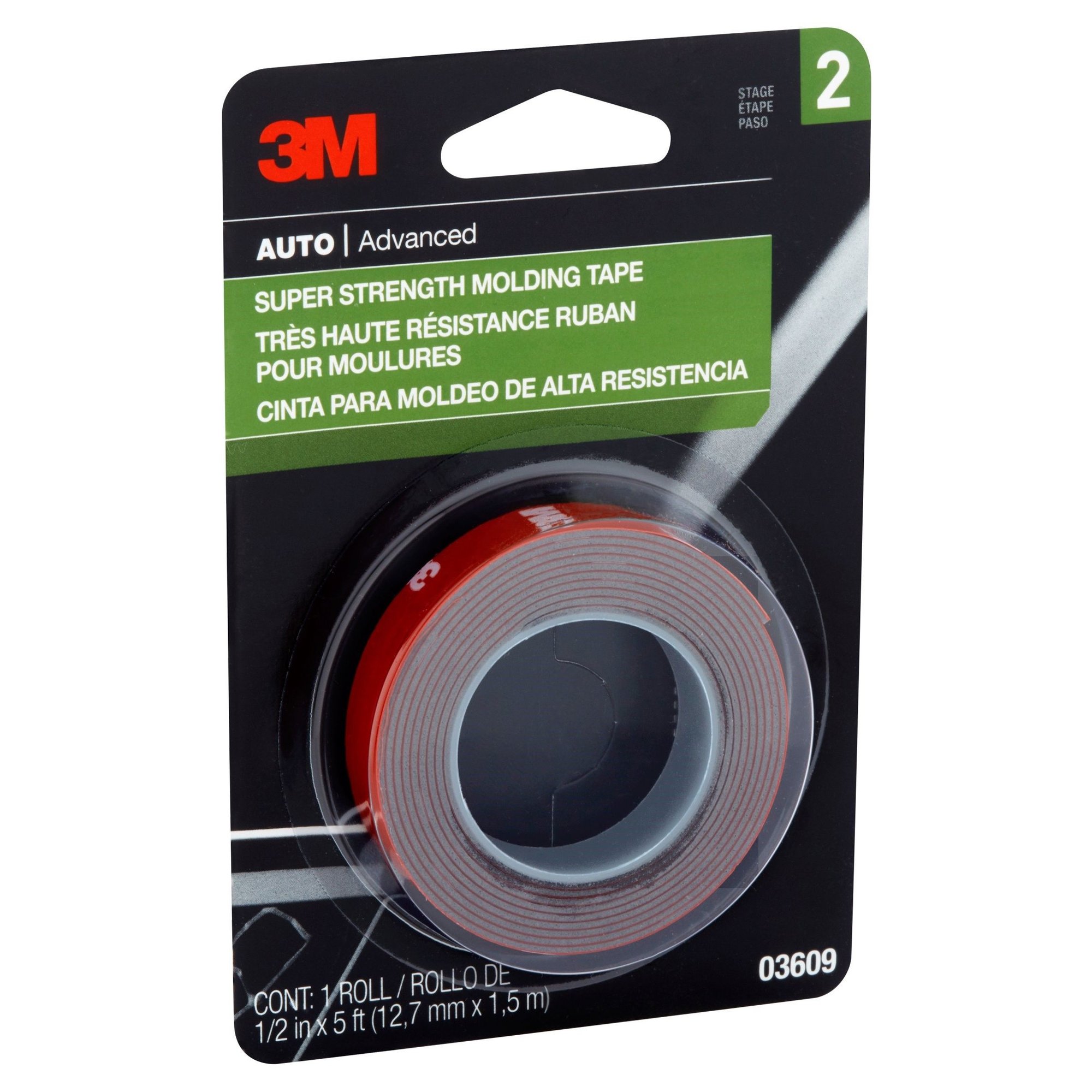

3M double side molding tape works
Old Jul 15, 2019 | 07:12 PM
Posts: 26,522
Oddly enough, 3M makes a tape for just that purpose.

Thanks Don. I'll take a look for it when I pick up new rotors and pads later this week.

Thanks for the pic, Man. Now I know what I'm looking for. Much appreciated, my Friend.

They make an exterior emblem/badge tape too. You want the type with no foam, if you can find it.
Or this stuff from AutoZone:

Can confirm. I painted the "base" of the emblems black and the middles to match the car and it looks good. I used those same 3M products. Also get some masking tape to hold the emblems on while the adhesive dries.
