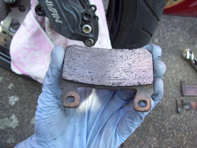

Old Mar 12, 2011 | 09:23 PM
Here's a four step checklist you can use....
1. Examine the brake pads visually. You can tell if the pads are glazed if you can run your finger over the surface and it's smooth. A shiny or crystallized look to the brake pad is also an indication that it has glazed over.
2. Listen for a squeaking or squealing sound when you press down on the brakes. This is one of the most common signs that the brakes are smooth due to overheating and have become glazed.
3. Listen for a continuous scratching or squeaking sound even when you don't press on the brakes. In this case, the brake pad may be consistently dragging across the rotor while you're driving. This continuous friction causes overheating that results in a glazed brake pad.
4. Test your vehicle's stopping power, when driving, in a safe location, such as an empty parking lot. If you experience difficulty with stopping the car, such as a delay in slowing down the vehicle or vibrations coming from the wheels, this could be a sign of glazed pads.
And here's a photo of a glazed pad, hope this helps.
