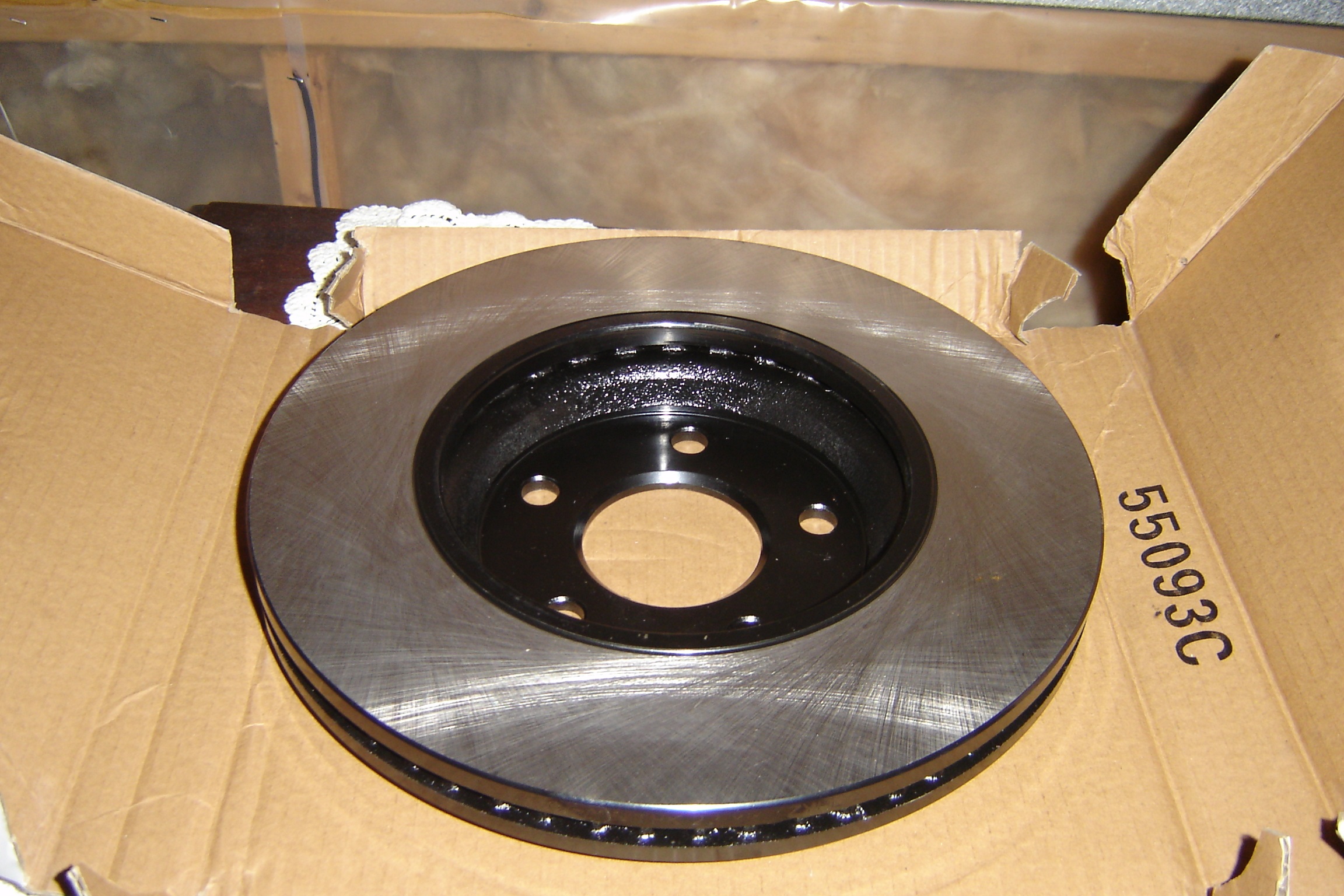

Posts: 40,082
After numerous brakes in the stock form , I switched to the larger SS non Brembo set up , smooth rotors, AC Delco ceramic pads.
No more brake judder, and I keep me rear drum brakes adjusted properly

Old Jun 15, 2017 | 08:25 AM
Posts: 40,082
Yes, just the rotors and calliper brackets, you will still have your stock callipers.
I have a set of SS callipers , the pistons are smaller in diameter then my stock LS callipers.
