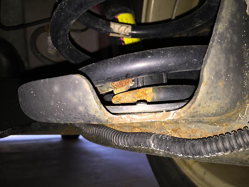

Right rear was clunking. When I finally got under to look I saw a broken spring. Anyone else had this happen? Mines an 08 with 115k. Any brand recommendations? I was thinking Moog

Stock height, Moog!

https://www.carid.com/moog/rear-coil...n-cc81065.html
X2 plus shipping or
https://www.chevyhhr.net/forums/clas...dropped-58350/
One price, includes shipping!

one other I have heard of. https://www.chevyhhr.net/forums/gene...springs-41167/
You should probably consider new jounces and isolators (the top & bottom seats).

Thanks for the quick responses. I'll look at parts tonight including shocks (there original).

$82 for springs & shocks (Moog & Gabriel Ultra) from Rock. I ended up using a spring compressor because my rubber brake lines seemed to be stretched to the max and there still was not enough clearance. Only video I could find was for a Cobalt that seemed to have a different brake line setup, allowing for more pivot of the lower arm?

I used a prybar to get the extra bit. I didn't have a problem with brake lines.
