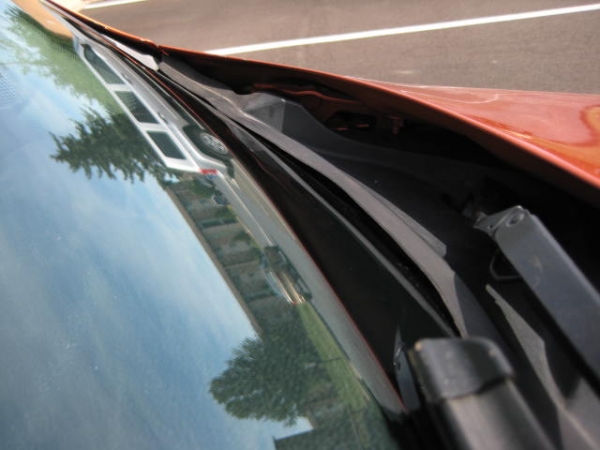

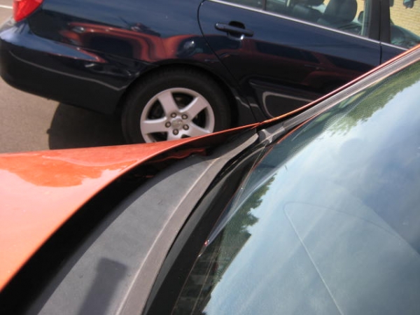

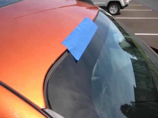

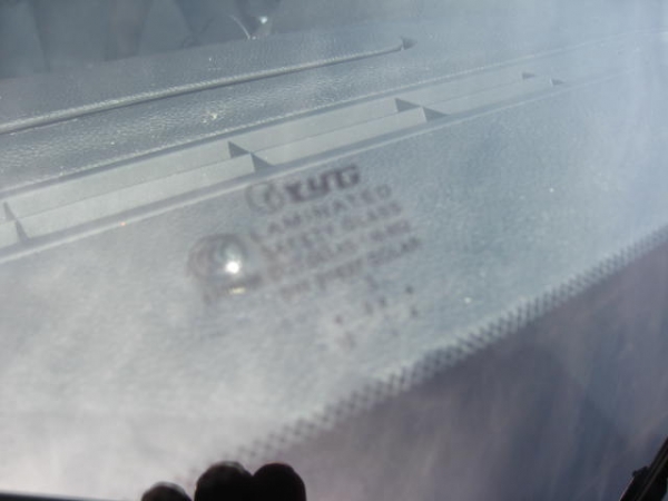

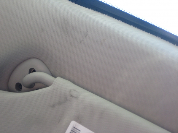

I have a 2008 LT. The windshield was replaced today at Belle Tire. When I picked up the car I noticed that the top of the glass didn't look like it fit correctly. I asked them if it was PPG glass like I had specified and they said it was; although it has a logo that says "XYG laminated safety glass."
The Chevy dealer that had told me to take it to Belle Tire is just down the road so I stopped in and had the body shop personnel take a look. They agreed that it's messed up - either wrong part or faulty manufacturing. Flush at top center but not at top corners. Not aligned correctly with VIN tag. Cowl not sitting flush. They recommended that I take photos and send them to my insurance company, Auto Owners, and have another windshield installed. So that's what I'm doing. I will see what they have to say. Not sure, but the chat on the web is indicating that the PPG subsiduary "Pittsburgh Glass Works" may be importing these replacement windshields from China.
My first time trying to attach photos, so hopefully this works…

Bummer, whatever happened to pride in your work, and not just there you go, now pay the bill ? seeing as the windshield is an important safety feature and proper install is a must for the airbags should they be required. I'd be hounding Belle Tire on this one.

XYG - http://www.xinyiglass.com/en/about5.html is located in the orient. It definitely is not associated with PPG. Yeah, Oldblue's suggestion about going back to Belle Tire on this one is right on. They ripped you off, not the insurance company, and they did a sloppy job on top of it all.
Old Sep 6, 2013 | 04:37 PM
That's pretty ugly, and something else to nail them with, HHR windshields are bonded in so that they contrbute to the vehicle's structural integrity when the adhesive is cured.
Resized your images, and incompetent doesn't do it justice, that's that job is plain crappy.

They may have omitted the plastic "wings". They are purely cosmetic, maybe some noise reduction. I had one installer ask ME how to put them on. I get new windshields basically yearly. The cowl does not need to be flush, once again cosmetic.
But, that is definitely "installer error"!!!!!! Really bad job. The glass is not to blame. I personally do not care where or by whom the windshield is made, they all pass the same tests before they get certified.

Let us know how you make out with dealing with the glass company, and are those scratches in the paint from their crappy work? I couldn't see the images first time I looked, but man that is all down to the clod who installed it, very sloppy very poor workmanship absolutely no pride in his or her work.

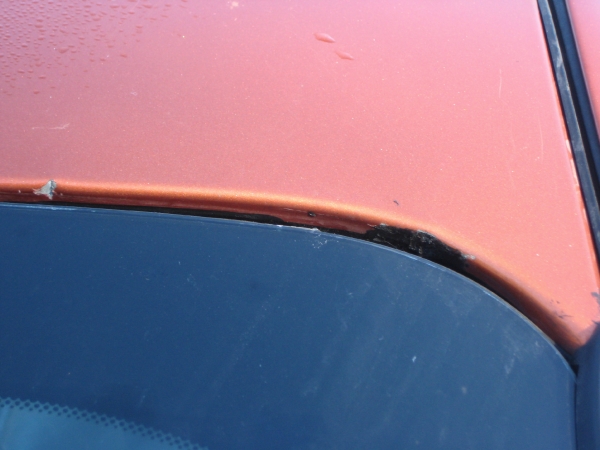

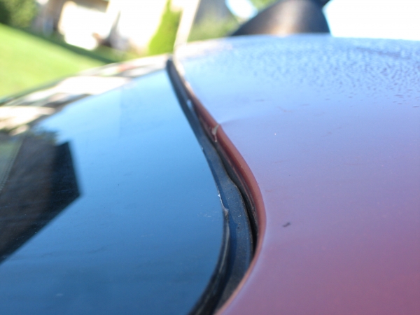

Yes, the damage is from the crappy windshield replacement at Belle Tire. That was the original glass that they removed.
I stopped in at a couple body/glass shops this week to get some info and advice. They confirmed my suspicion that “XYG” is 2nd rate aftermarket glass made overseas. PPG sold their auto glass division a few years ago. The new company is called PGW (Pittsburg Glass Works). PGW still manufactures quality glass similar to what PPG did, some domestic and some overseas, but they also supply their customers such as Belle Tire with the cheap XYG glass that was installed in my car. That is why the assistant manager at Belle Tire quickly flashed a PGW shipping invoice in my face but then refused to make a photo copy of it for me. He tried to pull the wool over my eyes by saying that it was indeed the PGW glass I had ordered and that “XYG” only refers to the solar tinting.
When I stopped in at Safelite they happened to have a PGW windshield in their company car, which also happened to be a Chevy HHR! It looked good… had a “PGW” logo at the bottom of windshield. They gave me the PGW part number. They also recommended glass made by Crimanex, which is the original manufacturer of the glass for the HHR.
IT DEFINITELY DOES MATTER WHO MAKES THE GLASS. Not only does the XYG brand windshield not look and fit good, the black XYG logo is directly over the light sensor for auto headlights, which means the lights are going to be on more.
I took some additional photos this morning (can a moderator please resize them for me, thanks)…
