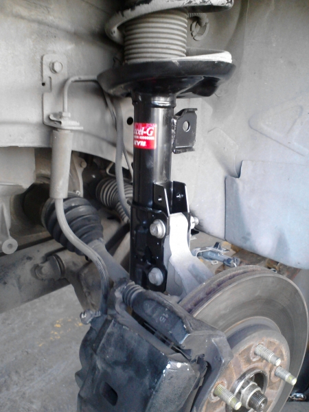

Finally replaced. Today I went to the shop to install the front struts and strut mounts
OEM were busted as I had suspected! The shop guys suggested to me change the sway bar links and I said "okay, Chinese parts are better than ruined parts". Then, they finished

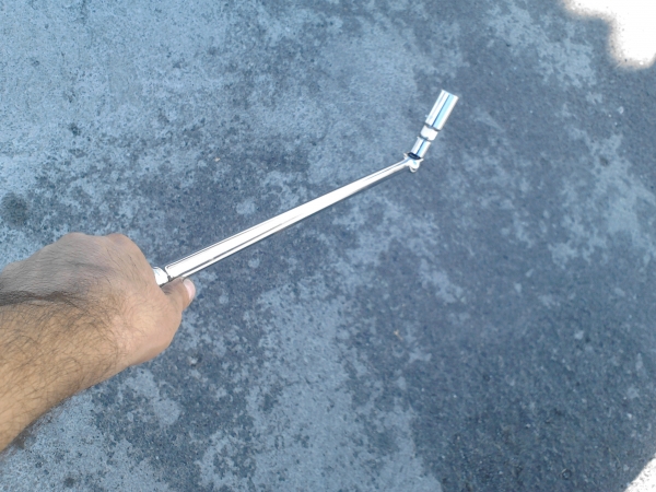

I decided to rid that &%$)"=@ noise using a 21 mm socket with a 3 ft Lever (That I already had)
Just tightening and no more knock!!!! And I am happy to be a HHR owner again!!!
