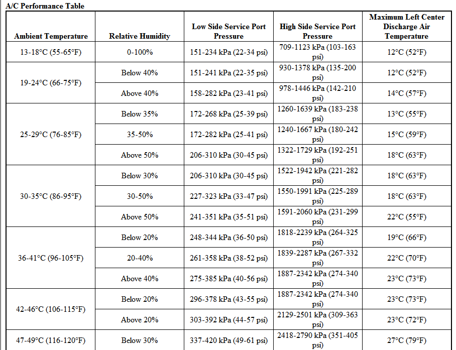

I'm not sure if your description is too technical a not technical enough, but I don't understand the problem.
Are you saying that the compressor is working, but not cooling? It works for a while but quits?
The A/C will not operate if there is a CEL, usually a P0128 is the cause.
Year and model would also be helpful.

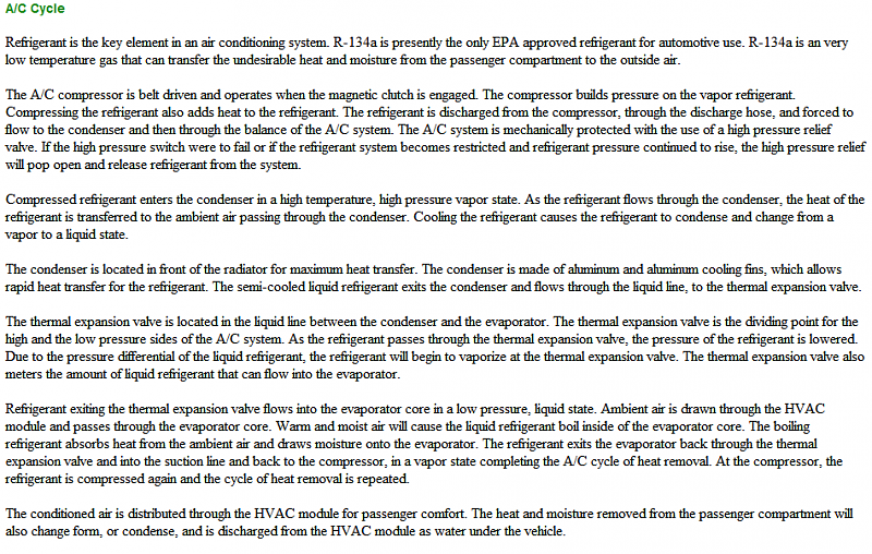

The only way that the pressure can be regulated is with the clutch. If the pressure switch senses too low it shuts the clutch off. If the pressure is too high r134a is vented to atmosphere, meaning it would need recharging.
You seem to be saying that the compressor is always running, but pushing hot air?
The heater core is always hot, if the blend door is stuck that would cause dehumidified hot air to come into the cabin. Does that help?
The outside air comes into the HVAC box on the cold side and mixes with heated air when commanded.
From Mitchell:
