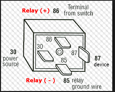

I just don't see the BCM as a suspect. The ECM supplies GROUND to the coil of the relay. You could test the relay by jumping pin 87 and pin 30 (on the fuse box) and see if the clutch is getting power.

Hey DonBrew, that relay image that you posted above - I just find the relay for the clutch and then identify the pins (87 & 30) based on the configuration? ...no "87" on my fuse box...
