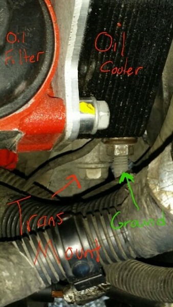

Could be a starter smell. Still sounds like a ground issue if the new starter doesn't help. There are 2 or 3 large grounds buried behind the charge piping attached to the trans (or close) they are near the round plug on the front of the trans. This is where the fuse box is grounded, or at least mine was. I just had the whole wiring harness out a week ago, I will try and shove my Note 3 (lol, huge phone) in there and get a pic of them.
