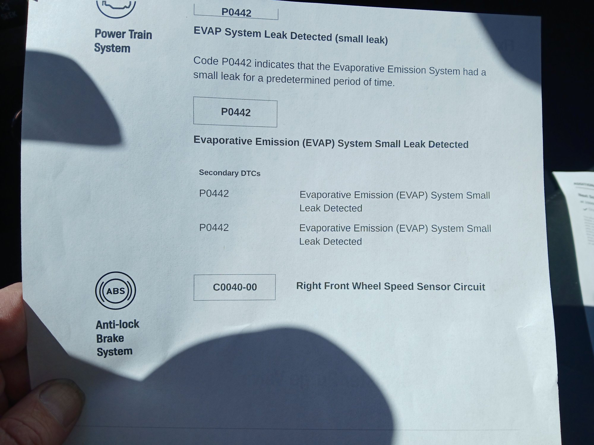

C0040 is only part of the code there is a - something or other in the code. It pertains to the right front speed sensor, a loose wire harness connection or internal issue to the wheel bearing hub.
Meanwhile back to the P0442, any progress?

Originally Posted by Oldblue
C0040 is only part of the code…
IDK about that, but it sure narrows it down. Merits a hard look for a damaged wire or connector.
C0035 Left Front Wheel Speed Sensor Circuit
C0040 Right Front Wheel Speed Sensor Circuit
C0045 Left Rear Wheel Speed Sensor Circuit
C0050 Right Rear Wheel Speed Sensor Circuit

All codes have a hex number after them that defines extra information, most don't get shown. In the case of the the wheel speed sensors:
00 "no additional info"
0F "erratic signal"
18 is amplitude less than minimum"
So far so good on no cel. Cleaned up the cap and rim. Dirty. Like was said before time will tell.

BTW this was what was printed out for me from autozone
Page 1 bullet 7 confirms our suspicions, fuel cap!
come to think of it, I remember several members having trouble with locking fuel caps back in the day!
thought I kept the old one, may have to go to junkyard and get one there

If you're not getting any ABS or traction control lights. you could just ignore the C0040 for now.
