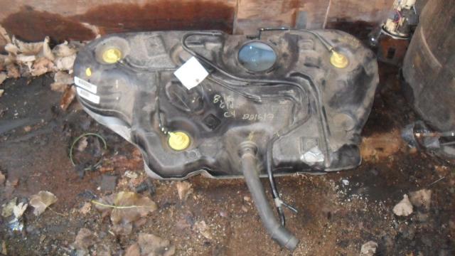

this is a shot of the tank I found some listed on E-bay from $35.00 to $200.00 plus shipping of coarse so which is the broken / cracked part?? and why added all up nowhere near $1000.00

I am guessing they are talking about one of those hoses or yellow nipples they are connected to. I have no idea how to cause those to fail, except for somebody has previously had the tank out. How the heck could they get up there to see smoke?
