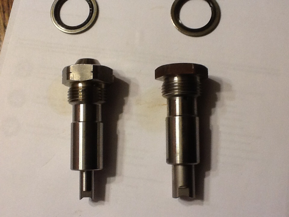

Old Nov 27, 2015 | 06:24 PM
Lucky's Avatar
Joined: 12-24-2007
Posts: 2,873
From: Seville. OH
It should. The new updated version has a hump on the end of it. The one on the left is the updated version.
Old Nov 27, 2015 | 08:52 PM
Posts: 40,097
X2 as Lucky points out , just reach down on the left side rear of the cylinder head on a cold engine and the bump will tell you, now these do wear out eventually, but don't fail like the old style does!!
